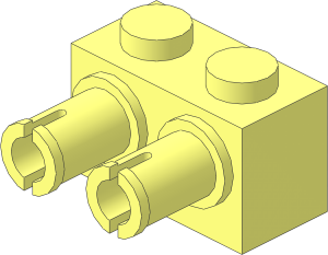

Needs 2 More Votes (F)
None
2025-03-25 22:48:46
Peter Blomberg [WUIt]
made the following comment.
2025-04-22 19:30:05
What was the purpose of the rewrite? Why was it done?
Rene Rechthaler [Blechtaler]
2025-04-22 19:46:01
license/author change maybe
but idk why the rework had to redo the complete brick...
could use s\3004s01.dat
should the pins get cut out from the surface (via ndis)?
2025-04-22 19:48:00
Inlining the 3004 parts (which is a bit more "clean") I guess.
Just looked at a real one and I am confused - the Technic pins have clearly visible friction ridges, but act like friction-less ones. Should this get the friction ridges in the model?
Also since you are using a box with missing front, should there be 2 ndis at the front as well to avoid the T-junc?
