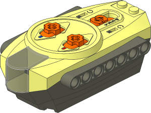

Hm...
There's now a small collision between the unskewed orange button and the casing ...
The screw is upside down.

Oops, corrected the screw!. Rotated the slider instead of skewing it.

Wouldn't it be better to simply lower the slider, so that a inlined copy becomes easier to adjust. Like you did on the small black buttons.
As it is positioned now, the slider ends up in a collision with the body, when it's in the other end position.

hm, as of now we can see "outside" when looking into the IR lens...
do we need some kind of "inside" there?

either we need vision blockers inside ore the lens needs a full inner surface

If that is an issue it is unrelated to this assembly and should be fixed in the sub parts.
Please lift your vote.

would it be legal to add additional faces/boxes here or do the subparts have to get fixed for that?

The shortcut should only contain real parts. Not fictional vision blockers.

ok then I will wait until the parts get fixed 8mstly top and bottom, they already have "needs work"

Please lift your hold vote. We will/have change the transparancy of the IR black colour code.

changed already? looks darker, but still transparent (which is ok) -> still needs a solid inside

Lift the hold. Your reason is invalid.
